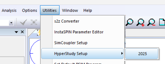

Hi @Hjun,
From PSIM, go to Utilities > HyperStudy Setup > 2025:
PSIM should be present in HyperStudy afterwards.
Rafael

Hi @Hjun,
Rafael
Instead of 2025 you should see 2024
