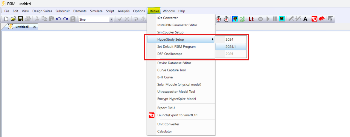

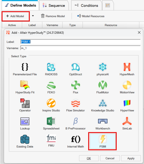

*Before watching the tutorial video, please ensure that the PSIM-HyperStudy connector (introduced in PSIM v2024.1) is installed via the "Utilities » HyperStudy Setup" option in PSIM.
This step will enable the PSIM icon inside HyperStudy:
Once the connection is successfully established, you can proceed with the step-by-step tutorial.
