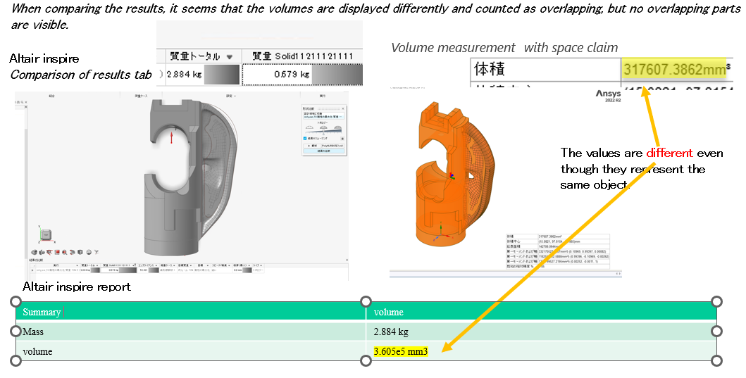

When clicking the "Comparison of Results" tab after performing structural optimization, the optimized result is displayed, but the displayed mass value is clearly incorrect.

Even when overlaying the original shape, there is clearly no added volume, yet the mass has increased.

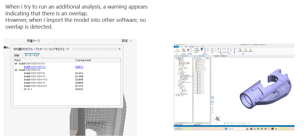

No structural overlap has been detected, and even when checking with other software, no overlap was found. There might be some kind of overlap that is counted only within this software, but I don’t know how to display or check for that.
