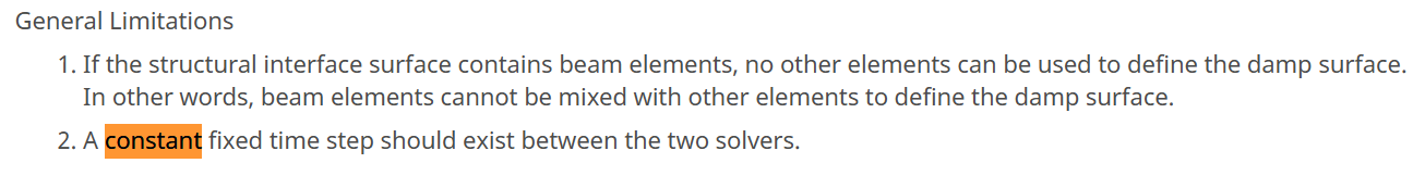

In theory, FSI requires the solid and fluid sides to synchronize their time steps for correct coupling.
- Currently:The solid side does not follow the specified multiple time stepsThe fluid side executes correctly
Therefore, even though the fluid results are generated successfully, the overall FSI solution is not reliable due to the unsynchronized solid side.
