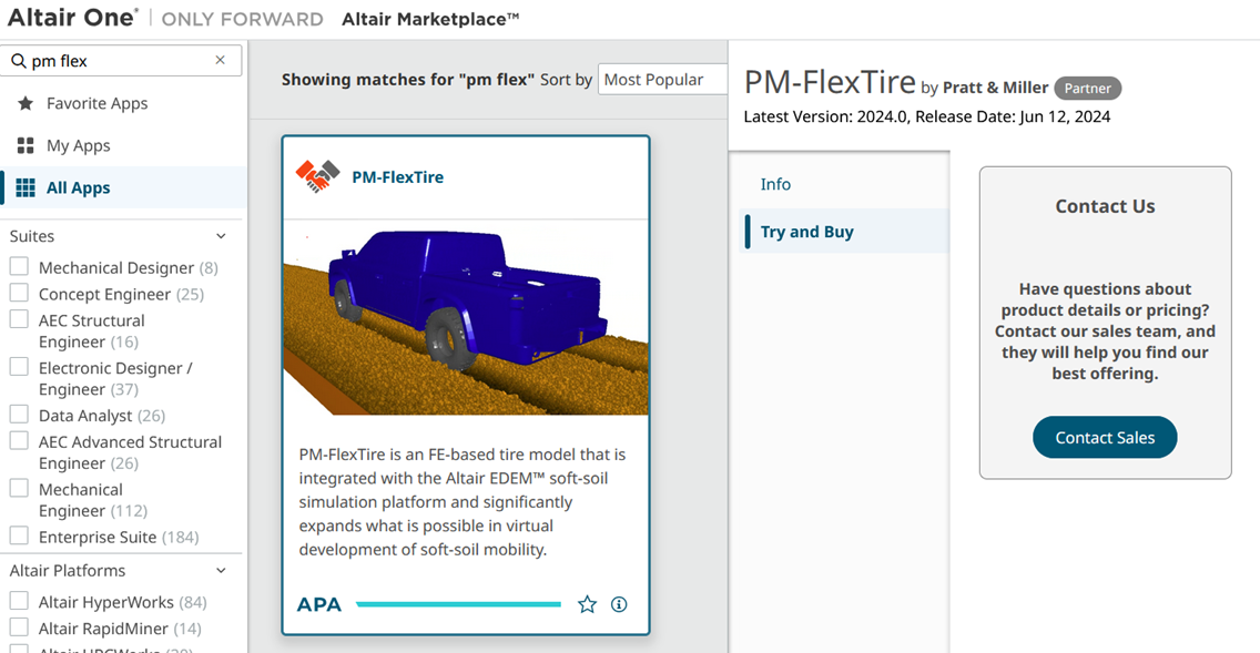

The PM FlexTire™ solver and example files are available for download on the Altair Marketplace. PM FlexTire™ is available to Altair customers through the Altair Partner Alliance. To access the solver, users must first contact their Altair sales representative to request access.
Once access is granted, the solver and example files can then be downloaded from the Altair Marketplace.

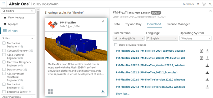

Download the Installation Package
- Navigate to the Altair Marketplace.
- Select your operating system and version.
- Download the installation package, which includes:
PME_FlexTire.dll
(PM FlexTire™ Solver)STPtoOBJ.exe
(PM FlexTire™ Pre-Processor)- User Manual (PDF)

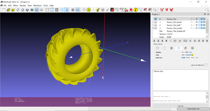

Optional: Install MeshLab for Visualization
To view .off
files generated during the PM FlexTire™ meshing workflow, you may install MeshLab, an open-source tool for processing and visualizing 3D triangular meshes.
