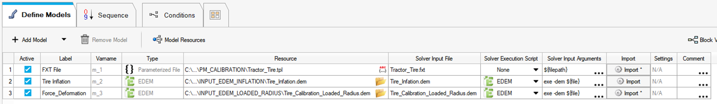

Three models are used within the HyperStudy setup to calibrate PM FlexTire™ inputs based on force-deformation data. The first model is a parameterized .fxt file containing the material and geometric properties to be calibrated. The second model is an EDEM simulation to inflate the tire, capturing its radial expansion under pressure. The third model is an EDEM simulation to generate the virtual force-deformation curve, which is then compared to your target data for calibration.
The HyperStudy user interface, used to manage and execute the PM FlexTire™ calibration workflow, is shown below:

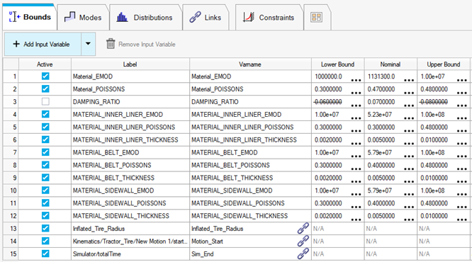

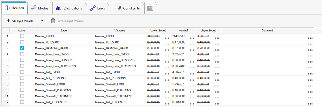

The input variables and their defined upper and lower bounds used in the calibration are shown below:
The table below lists the recommended input parameter ranges for calibrating an isotropic tire model.

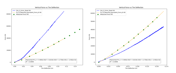

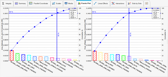

The first design of experiments (DOE) in this investigation used a D-Optimal approach with approximately 25 iterations. This DOE had two objectives: first, to verify that the simulated tire force-deformation curve (blue) fully envelops the target curve (orange), and second, to identify which input parameters have the greatest influence on the tire’s force-deformation behavior.
Use the Pareto plot to identify and eliminate factors with minimal impact on the tire’s inflated radius and the area between the curves before running the optimization.
In the final step, the model is optimized to minimize the difference between the target force-deformation curve and the simulation-generated curve.

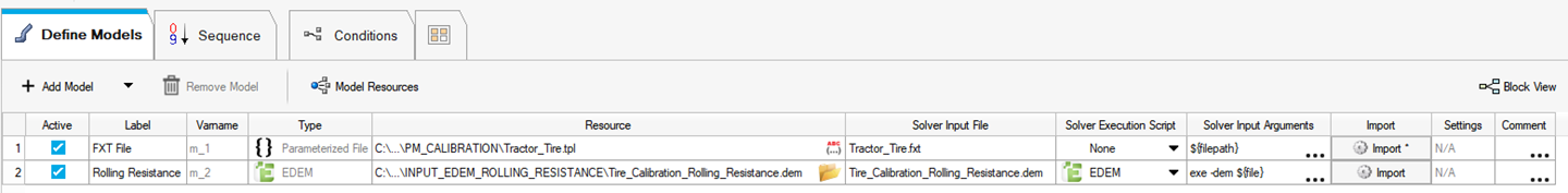

Two models are used within the HyperStudy setup to calibrate PM FlexTire™ inputs based on rolling resistance. The first model is the same parameterized .fxt file used during the force-deformation calibration. The second model is a final EDEM simulation used to quantify the tire’s virtual rolling resistance, which is then compared to the target data for calibration.
The HyperStudy user interface used to manage and execute the PM FlexTire™ rolling resistance calibration workflow is shown below:
The input variables and their defined upper and lower bounds for the rolling resistance calibration are shown below:
The table below provides the recommended input parameter ranges for calibrating an isotropic tire model.

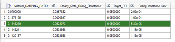

The first design of experiments (DOE) in this investigation used a D-Optimal approach with approximately two iterations. This DOE aimed to verify that the simulated tire rolling resistance fully captures and envelops the target rolling resistance value.

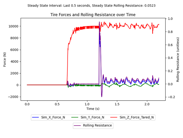

The output from the EDEM simulation, shown below, includes the forces acting on the tire in the three principal directions and the rolling resistance as a function of time. Rolling resistance is calculated as the ratio of Sim_X_Force to Sim_Z_Force.
In the final step, the model is optimized to match the simulated rolling resistance with the target measurement.
