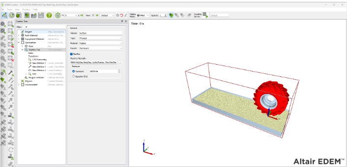

Enable PM FlexTire™ Solver in EDEM
Tools > Options > Additional Components > Enable FlexTire

Specify Air Pressure and Inflation Duration
- Set the air pressure for the tire.
- Set the inflation duration to approximately 100 EDEM timesteps to achieve stable and quick inflation results.
