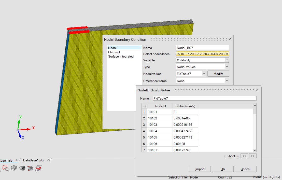

I'm encountering an issue with AcuConsole (version: [2023]) when defining a Nodal Boundary Condition using Type = Nodal Values
Here's what I did:
- Created a
NodeID-ScalarValue
table (e.g., FldTable7
) with 32 nodes and their corresponding X velocity values. - Assigned this table to a
(named Nodal_BC7
) with the correct Variable = X Velocity
and selected node IDs. - In the GUI, everything looks fine – the table is selected.

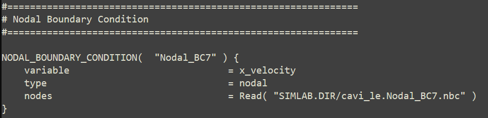

- However, when running, I get the following error:
*** ERROR: Parameter nodal_values is unspecified

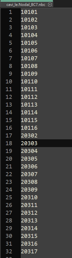

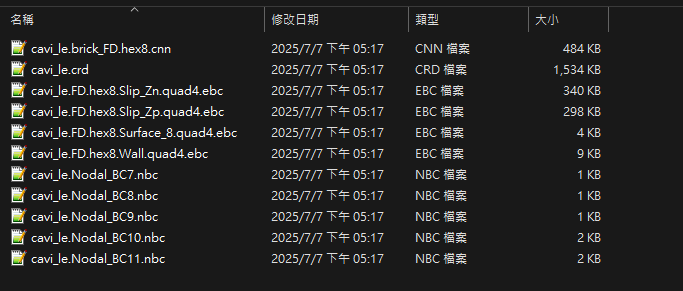

It seems that when exporting from the GUI, only writes the node IDs but does not include the nodal_values
parameter, even though it was properly selected in the interface.
