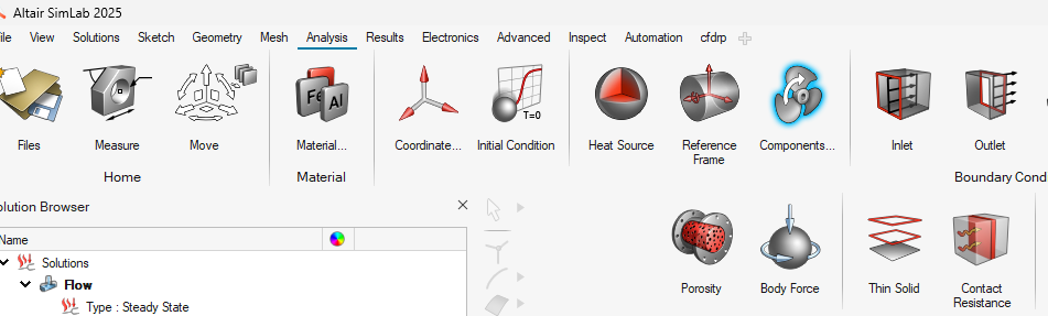

I need to apply contact resistance between two bodies in acusolve. The faces selected are the shared faces between two bodies. The error above is shown during acusolve run.
How to resolve this issue?
Ideally I would suggest to work with "Thin Solid" option and not the Contact Resistance, as the first one is solver native and second one translates data input to Thin Solid. There can be some issue with such translations.
Apart from that, we would need your .inp and .Log to give you an answer. That snippet is insufficient….
