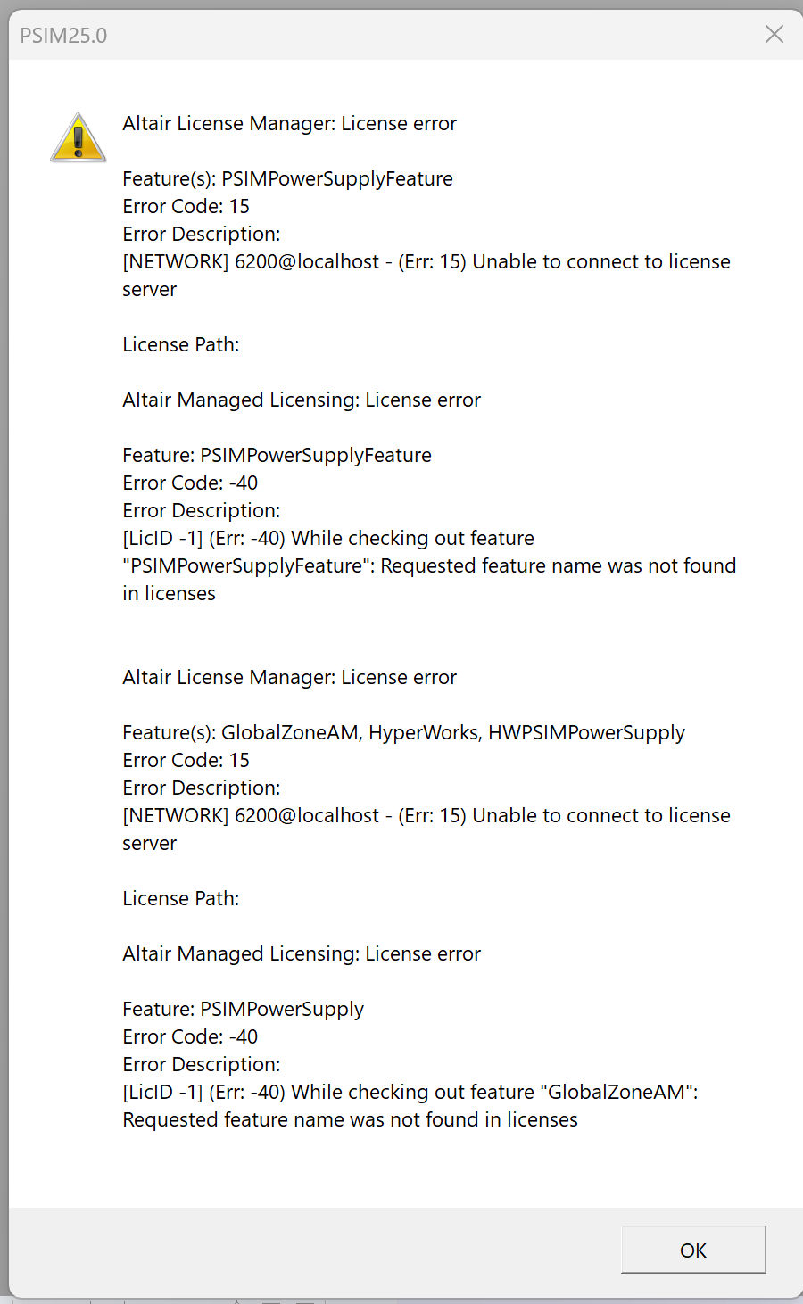

Hello,
I installed the student version provided by my instructor. I get the attached error after opening the PSIM software.
From the installation location of the software, look for the security folder and go into the gui folder. Open the almutil_gui.
The activation key is found from the student edition license from the altair marketplace.
Enter the activation key and press the activate button.
