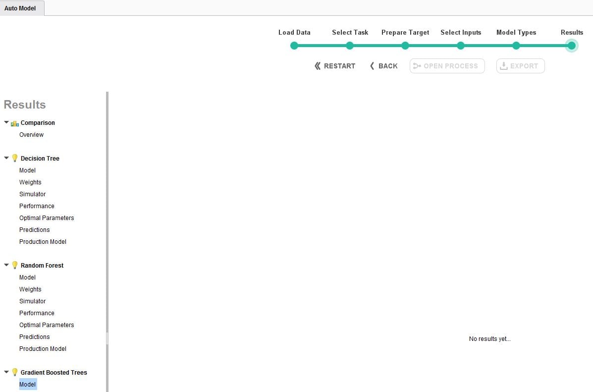

I ran Auto Model on a data set (I selected Decision Tree, Random Forest, and Gradient Boosted Trees). Afterward, I went to look at the results (see below):
For some reason, the only subheading under Gradient Boosted Trees that displays anything in the main/center pane is "Performance". All the rest of them only say "No results yet..." (see below):

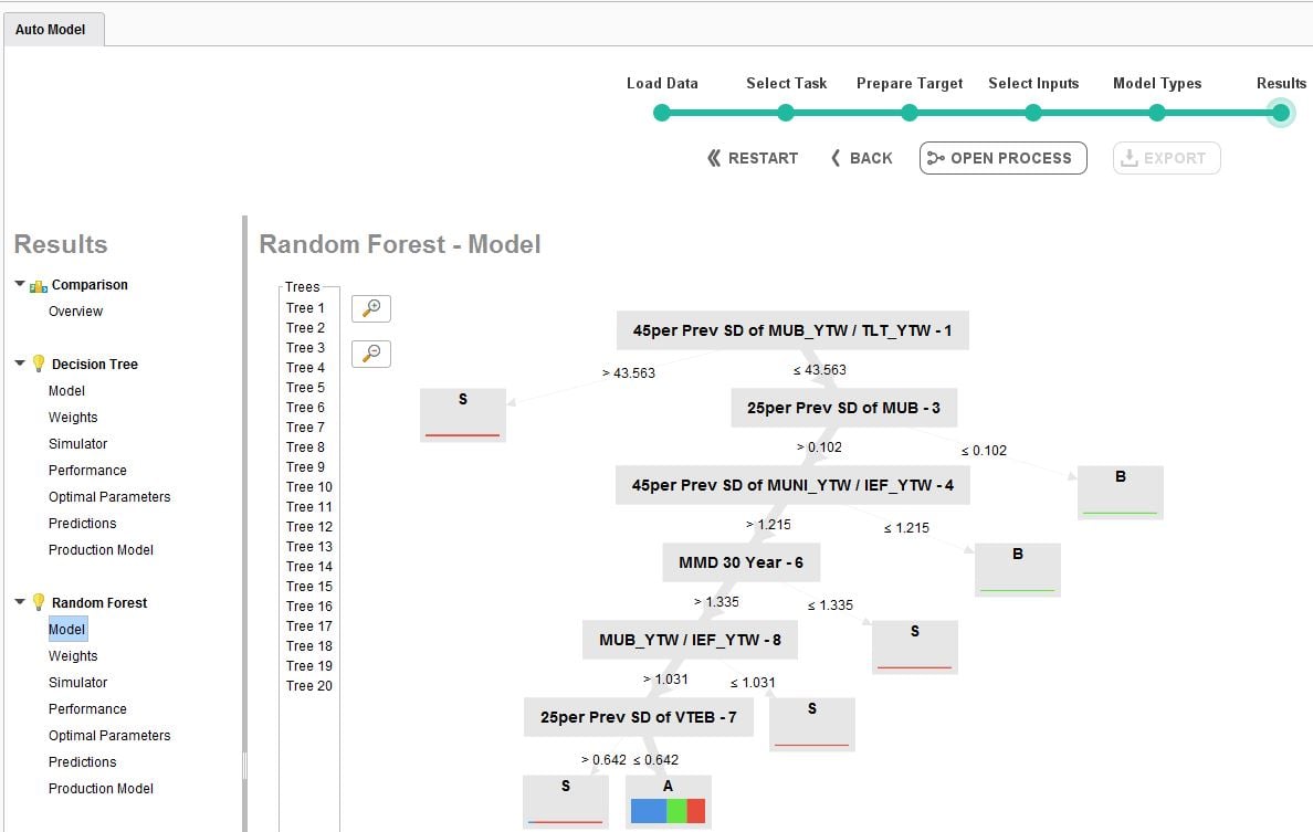

I'm particularly interested in looking at the Graphical Model "viewer" (below is the Random Forest's version):
Is there any reason that Auto Model's only output for Gradient Boosted Trees appears to be a confusion matrix?

    Hi @Noel_D,
    Yes this is a known issue, and I think may be fixed in a recent release - out of interest what version are you running?
    The GBT results are still there, you will need to save them and then individually access them from the AutoModel results folder.
    Let me know if you need any more information.

    Hi @Noel_D,
    Okay, I think a new version isn't too far away which will address that issue.
    Unfortunately right now you won't be able to see the results via Auto Model at all. Where you save the results you should see the following structure in the repository.
    If you expand out Gradient Boosted Trees, you will find all the content which appears in Auto Model:
    Say, I want to see the Model Simulator, I can double click it here and use the Simulator:
    Hope this makes sense.
