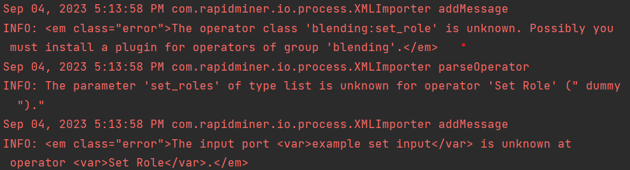

Hello, I've integrated RapidMiner Studio Core into a Java Application as a dependency to run RapidMiner Processes previously exported from RapidMiner Studio. But everytime I try to run a process containing f.e. the Set Role Operator, I get the attached Error.
Apparently the "Set Role" Operator is part of the blending extension and not part of RM Studio Core. Is it possible to execute Processes in Java containing such Operators from internal extensions given the appropriate License? Are there any methods I need to use to initialize a License or (internal-) extensions?
