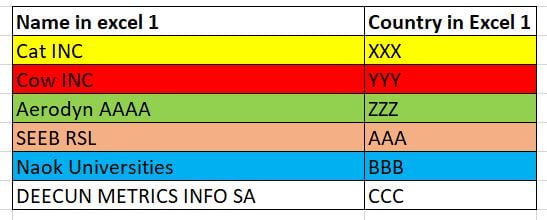

I have 2 excels. Both have the company name and country data. But the company names are similar and are not the same. So using the country data (which is the same), I have to match the company names and display the final matched data in one excel file. I have also attached the example of the data in both excels. I have colour coded it so that they can be understood as the similar company names (Cat INC = CAT LLP). I created a model which uses operators like replace (with lots of manual work like entering the replaceable values). Also, the real data file consists of 1000's of rows in it. So it would be helpful if someone could suggest a model type which can compare and match data between 2 files.

I want to give a clarification on my query.
I have 2 excels. Both have the company and country name. But the company names are similar and are not the same. I have to match the company names(even if one of the words in the names are matching, eg:Cat INC and CAT LLP should be matched) and display the final matched data in one excel file as shown below (3). I have also attached the example of the data of both excels (1&2). I have colour coded it so that they can be understood as the similar company names (Cat INC = CAT LLP). Also, the real data file consists of 1000's of rows in it. So it would be helpful if someone could suggest a model type which can compare and match data between 2 files.
