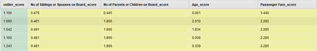

The out port contains a table with all the information you need.
 We added a column containing an overall outlier score, which aggregates the scores of the individual columns. Usually this is the average of the columns, but you can also get the max or the product.

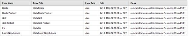

To manage your repository from processes we added the ability to scan it! The List Repository Object can be pointed to any directory and gives you all the objects in the folder structure.
This allows you to also execute every process in a folder by combining this with Loop Values and Execute process. There are multiple other use cases if you combine this with loops.

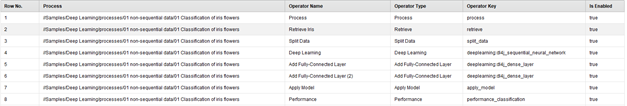

The Scan Processes operator allows you to go deeper into processes. It gives you a list of all operators used in the processes of a folder.
One use case for this is to search for deprecated operators or operators you do not want to use anymore. Another use case is of course to analyze your own processes using machine learning!
