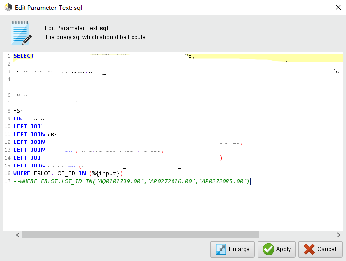

As below, i have a column "concat(lot_id)", i want to set this column value to a macro which named "input"
Then i can use this macro in SQL like:
But if I do like this, macro input value is always [concat(lot_id)], so what did i do wrong, and how can I set a exist column value to a macro?

    I think the operator you want to use is Extract Macro and not Set Macro. Extract Macro allows use values of an example set to define a macro. Set macro just sets constant macros.
    In Extract macro you choose data_value as an option and select your attribute.

    Thank you so.....much, my issue was solved via using Extract Macro!!!!  :)
