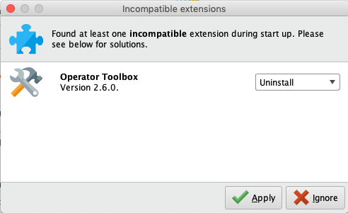

I'm trying to run a decision tree model and produce the decision tree path for each example. There's an extension called Customer Operator Toolbox (2.6) that does this but I get an error that it's not compatible with the current version of Rapidminer. The operator was updated 6/10/20.
Do you have other suggestions? I've seen on some threads that you can use generate attributes, but this produces a metadata error in subsequent operators. Is there an easy way to produce the tree path without this operator?

Hi @bshockley ,
do you have the text processing extension installed? Toolbox depends on text and this is the error you receive if you miss a dependency.

I think operator toolbox would be the best way in this situation. I see you are on the latest version of the extenstion, and also the extenstion has compatablity with older versions of Studio. What is your RM Studio version? Can you check out the rapidminer-studio.log?
