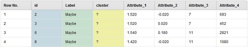

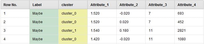

The issue I run into is that the 'Map Clustering on Labels' operator does not receive cluster results i.e. placeholder '?' value from the 'Apply Model' operator in the testing phase.
Any idea where this stems from? Outside of the X-Validation EM works just fine and there aren't many parameters I could tweak.
Thanks already!
x-means before map clustering:
EM before map clustering:

    Hi,
    I may be mistaken but I remember that the adding of the cluster column with Apply Model only worked with centroid-based cluster models.  Maybe somebody else can confirm or knows more?
