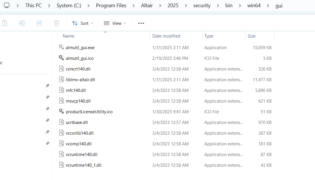

- Navigate to System (C:) > Program Files > Altair > 2025 > security > bin > win64 > Gui. Locate and double-click on almutil_gui.exe, as illustrated in the image below.

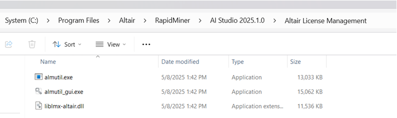

For AI Studio the location will be as below
