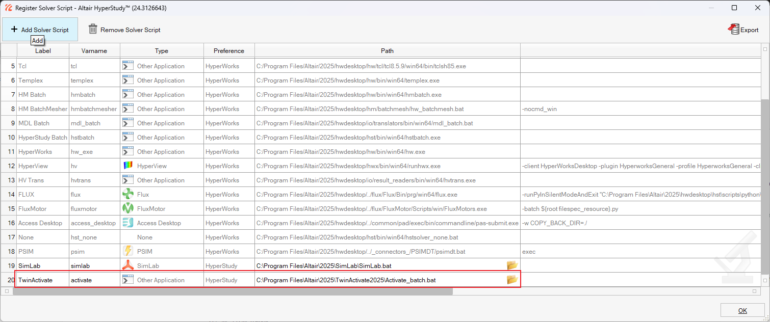

Hi Adam, I've finally found how to link Twin Activate and HyperStudy.
First, we need to prepare Twin Activate models for use in HyperStudy(Prepare Twin Activate Models for Use in HyperStudy).
Once we have a parametric design and a .csv output file in the Twin Activate model(s), we need to add the Twin Activate batch solver path to the "Register Solver Script" section in HyperStudy and type "-f" in the user argument block.
Then, we select "Parameterized File" to add the relevant file and use the editor to map a Twin Activate parameter to a new HyperStudy input parameter.
Finally, we can use Twin Activate models in HyperStudy. Best regards, Leon Lin
