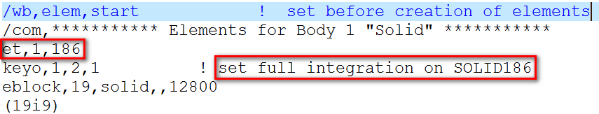

    I have uploaded my Ansys file in my previous reply.
    1. Why should more than 2 elements be used for solid? How to understand?
    2. I used the same model with Ansys and OptiStruct. That is to say, in Ansys, the elements through the plate thickness is also two. Why they give so different results?
    Thank you

    I wonder why ansys can capture it with only 2 layers. Does it have a better elem formulation than optistruct?
    Could be... I think Ansys supports thin solids and Roy is using the same for modelling.
    The same is not supported yet in OptiStruct

    Hi Prakash,
    Maybe we can output APDL input file from workbench by using Tools--Write input file. I have output from my model, and please check it in the attachment.
    From the dat file, the element in workbench solid model is SOLID186 and full integration is used.
    I think this element type is a very common second order solid elements. Does OptiStruct have this type elements? How to define it?
