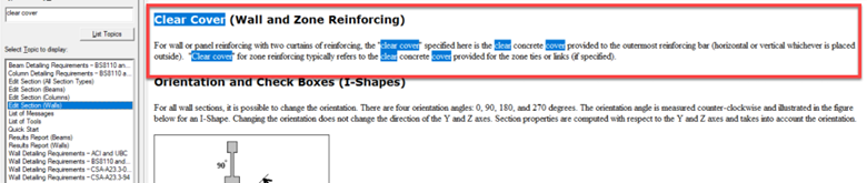

    We appreciate the elaboration and sending the screenshot along to aid in understanding the question. In this case, the clear cover in S-CONCRETE would be referring to c1 in your schematic, meaning the distance between the exterior of the stirrup and the top, bottom, or side of the section. To prove this, we can grab a default T beam, like the one on your screenshot, and set all the clear cover distances in the top, bottom, and sides to 0. By doing this, we will see that the exterior of the stirrup will be perfectly in line with the cross-section of the beam. Please refer to the image attached below (Clear cover and cross-section.png).
    The definition of ‘clear cover’ is explained in more detail in S-CONCRETE’s Internal Help System. You will also find a dedicated paragraph to it for every section type. Please refer to the images attached below (Clear cover for beams, columns, and walls).
    We hope this information helps clear things up. Feel free to ask any additional questions if necessary, the team is here to help.
