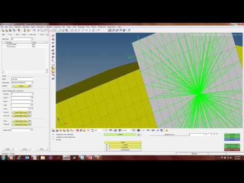

I am an engineering student and I take part to the Formula Student project. My objective is to do a 3 points bending tests on a steel tube. So I used the RADIOSS solver to do this. However I am a little bit lost because it is not the same options as Optistruct. Anyway, I was able to realize my test.
 However, now I would like to plot the force versus displacement on a graph but I don't know how to do it because when I want to create a graph it doesn't suggest to display the force but only ( velocity , displacement , von mises etc).
Could you please help me and tell me how to do it?

    Hi,
    the procedure to define output response and post-process the load-displacement results is attached.

    Hi Simon,
    Thank you very much for your help and this detailed video tutorial. Thanks to you, I'm making a big step in my project.
