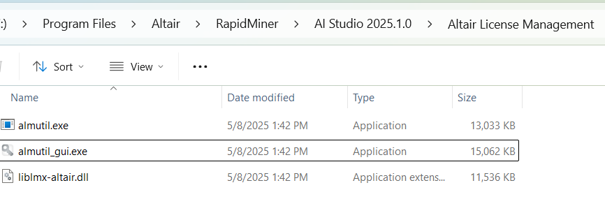

HI @tonyboy9
This means your AI Studio is still licensed with the free edition license on rapidminer.com
You do not need altair_licensing_2025.0.win64_x64 , you should uninstall this
You should find the almutil from the installation directory of AI Studio, such as the usual install location path here - C:\Program Files\Altair\RapidMiner\AI Studio 2025.1.0\Altair License Management
Once there you can do the step 4 with the almutil_gui.exe as explained here -
also you need to switch to Altair licensing from RapidMiner Licensing as explained in this post here -
