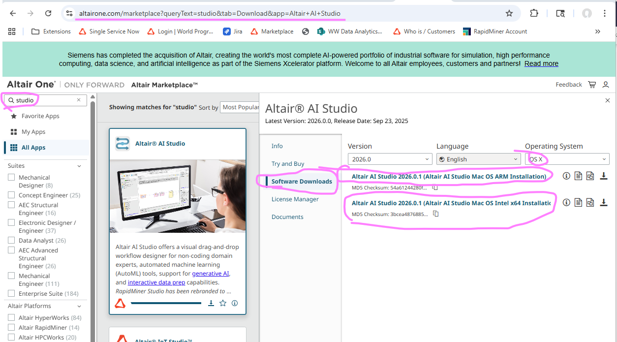

    Hi @Vani_Vasudevan I had reproduced the error on my own Mac and filed a defect with development.
    They were not able to reproduce and pointed out that for the version 2025.1, there are two different installers for Mac and we may have chosen the wrong one.
    When I get home I will be trying out the other installer on my Mac Book and will let you know the results. If you are able to try this before then, please let me know what happens.
    Thanks!
    User: "eabrandon"
    Altair Community Member
    Hi there, I am on Sequoia 15.6.1 and having this issue today. Was a fix ever discovered? I see the option to try 2025.01 and also that there may have been a faulty installer. I do have access to the file path in previous comments, but am unsure what to do at that point.
    I would appreciate any advice to bypass this error message. Thank you!
    Hi @eabrandon ,
    There are two different installers available - I'm not 100% clear on which one if for which type of processor but have found that one of them works properly on my Mac (Book Air) and the other does not.
    So you may want to try each installer and see if one of them works better for you.
    Note also that AI Studio 2026.0.1 is now available.
