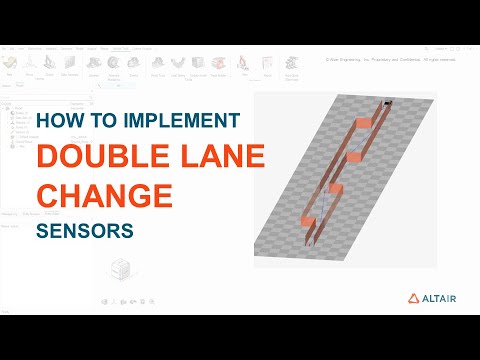

Curious about your vehicle model's ability to meet Double Lane Change Standards? This video demonstrates the effective utilization of MotionView sensors to fulfill this requirement! The integration of sensors for the Double Lane Change maneuver not only optimizes time during iterative processes but also enhances comprehension of your MotionView vehicle model's constraints. The tutorial encompasses various aspects: from the double lane change segments, importing and affixing the sensor system to a MotionView vehicle model, modifying section parameters, post-processing MotionSolve results, and expanding sensor integration for multi-axle vehicles.
