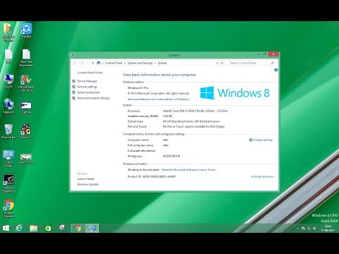

1. You could expand your ram using disk space see here:
https://www.youtube.com/watch?v=z_c60Osd__c
