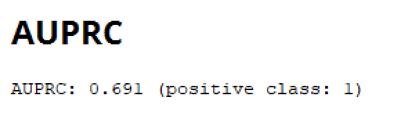

Hi, it seems I am not getting expected results when using Performance (AUPRC) with highly imbalanced dataset.
The relationship between recall and precision of positive class seems pretty intuitive, but I still get AUPRC = 0.010 regardless of anything:
I am using here imbalanced credit card fraud dataset.
At the same time when I artificially balance data, AUPRC shows expected 'normal' values:

    isn't that exactly what you would expect? AUPRC is NOT independend of class  balance. If you add more and more of one class, then the precision will go down for the other class. Thus the curve becomes flatter and the integral less. 0.5 is thus not the lower threshold anymore.

    Honestly, no, I have expected it exactly the other way around.
    If we assume that the curve shows precision against the recall of the same positive class (in our case '1'), then varying recall of positive class gives the following:
    Low recall, high precision (6/100)
    High recall, low precision (93/6)
    Around optimum (80/80)
    Or do I interpret AUPRC completely wrong? :) (never used it before in practice)

    Altair Employee
    Hey @kypexin,
    Here is how i see this. If you have a different class balance you transform the space. Essentially Recall for your positive class stays the same, but the precision for a given recall point changes. This may look like this:
    2018-04-26 11.14.35.jpgUpper: Normal PR-Curve, Lower with a different Class Ratio
    If you have a look at the math, you can see Precision as a function of recall like this:
    adding more Negative falues will lead to more FN (false negatives) and thus less precision. So naturally AURPC drops with changing class balance (if the classifer does not counter this.)

  • MartinLiebig
    MartinLiebig
    Altair Employee
    @kypexin,
    ive done some tests. Attached is my project on your data. For me the AUPRC drops heavily, as expected.
    100	0.6869897886710802
    200 0.540999353555299
    300 0.453043673642775
    400 0.39372295554318193
    500 0.3493142261965152
    Where the left coloum is the number of negative examples and the right one is the AUPRC. There is also a way to visualize the AURPC exactly like the operator does it.I think one good question is: How to handle missings in the integral. since i copied most of the code from AUC the handling is the same.
