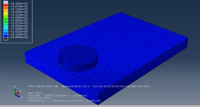

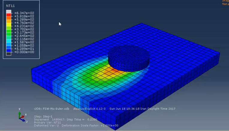

1. Can Inspire FWS do the "transient" simulation where the pin & the shoulder moving on the plate, like Abaqus or Ansys?
Below is one example from youtube:

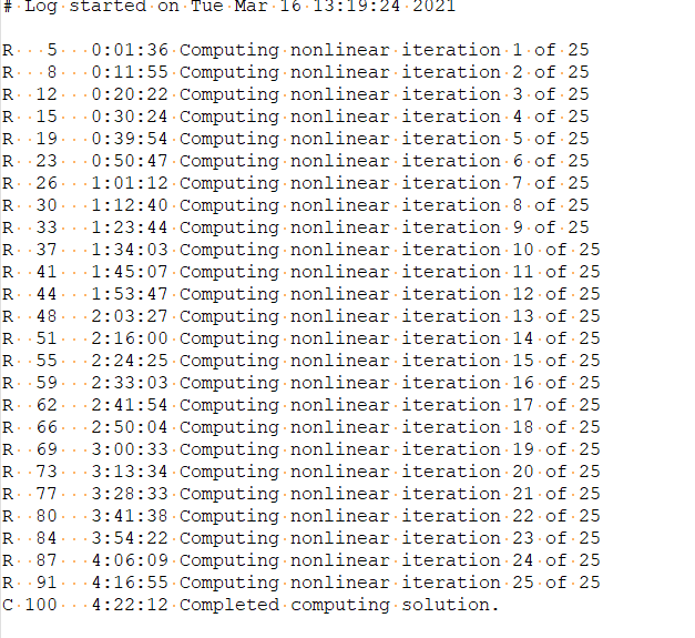

2. how to improve the computing speed?
i tried the simplest tutorial from the help, with medium mesh and the convergence tolerance is 0.01.
Running on 8 cores with 8Gb RAM workstation, the tutorial took me 4 hours to complete the "static" analysis
This is very interesting about this product.
And when i see in the task manager, the CPU and RAM is not working at maximum speed or capacity.
May i know why and how to improve this?
(i have already set the no. of cpu to 8 in the preference setting)
