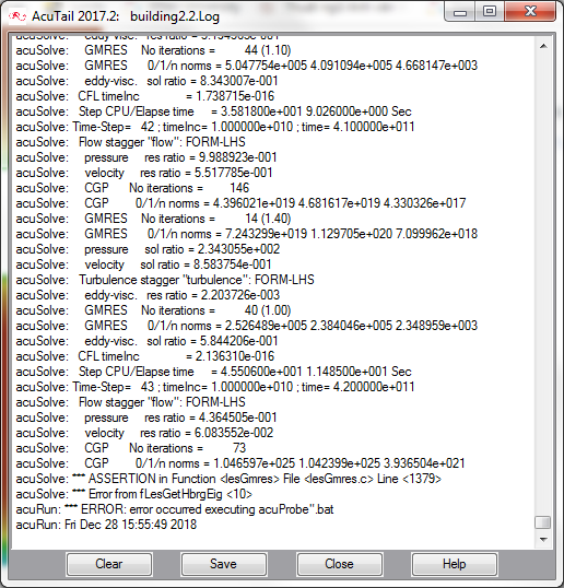

i am doing a CFD simulation using HyperMesh-AcuSolve.
When the solve is running, about step-40. the AcuTail display a message error as below:
acuSolve: *** ASSERTION in Function <lesGmres> File <lesGmres.c> Line <1379>
acuSolve: *** Error from fLesGetHbrgEig <10>
acuRun: *** ERROR: error occurred executing acuProbe'.bat
The model file is attached
please help me to fix it.
Thank in advandce!

thank you, i solved my problems. it is because of the mesh quality.

hi alpharays,
well, i created a finer mesh by using 'zone mesh refiment'
however, each simulation is different, could you describe your case?
Because the error may come from many reasons, including the mesh size.
Please attach the two input (.inp) files - the first where you get the error, and the second where it runs but you don't like the solution - along with the two complete .Log files. It's quite likely the issues are caused by the very coarse mesh in the model. You probably need finer volume and surface mesh, thinner first boundary layer element (so more layers) and better resolution in the wake regions of the buildings.
