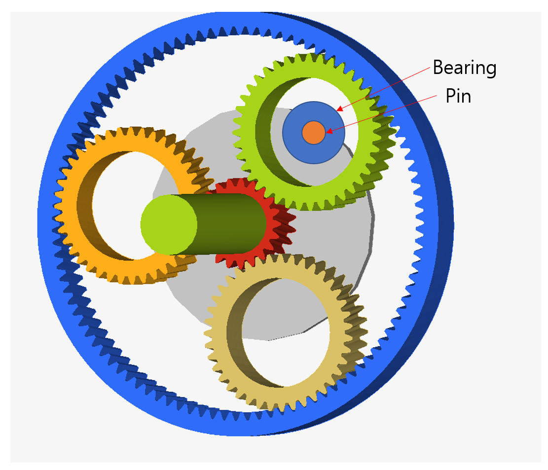

I'm interested in reaction force acting on bearing of planet gear in planetary gear drive
which would be as drawing below
While Planetary gear extension at Machinery tool is great since there is no body of planet gear when modeling given at tutorial I could not find a way to simulate bearing load at planet gear
