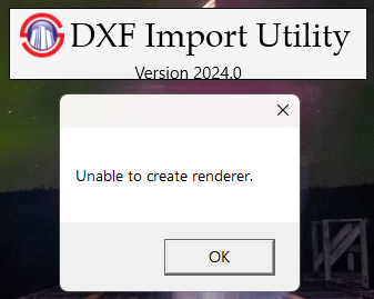

when i try to import DXF files from AutoCAD i keep getting this error, and cant view the model before importing it. How can i fix this?
Hello there,
This appears to be an issue with the DirectX function on your PC. Could you please download, and unzip the following file, and run it on your computer. It will ensure there is no missing directx function on your PC.
directx_Jun2010_redist.zip
Regards, Matthew Sauer
