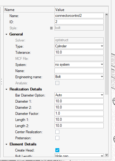

Hi guys, So, basically I have this problem: I’m not able to select the bolt type when creating a connection. I have all the available add-ins installed and I’m using the OptiStruct solver.
Hello

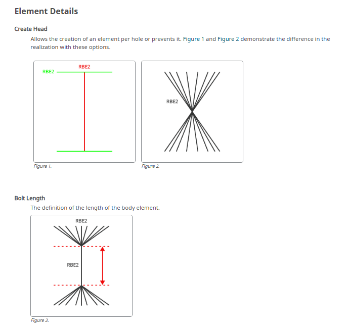

You should determine the type of realizations you want from the Realization Details.
https://help.altair.com/hwdesktop/hwx/topics/pre_processing/connectors/realizations/hole_r.htm
