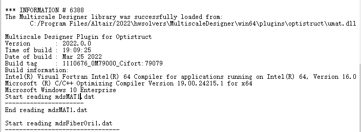

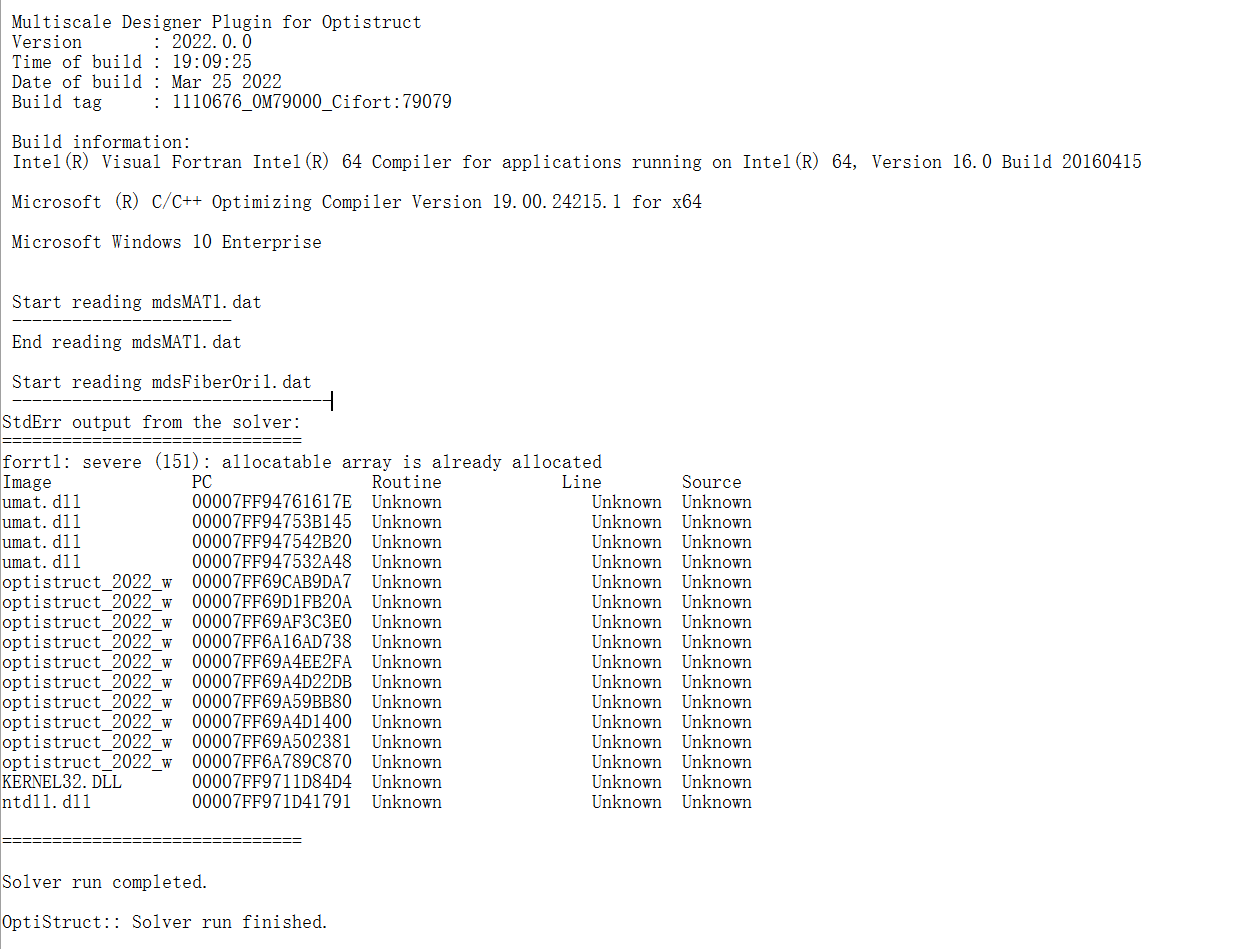

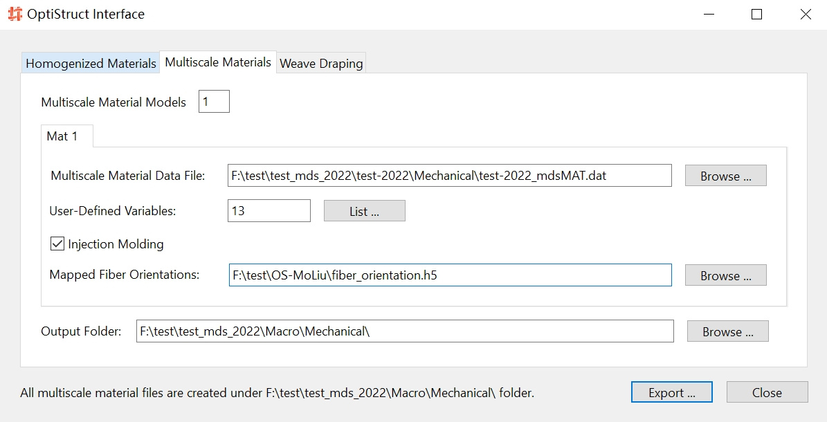

Hello everyone,I’m working on short fiber injection molding co-simulation using Multiscale Designer 2022 (MDS) and OptiStruct 2022. So far, I’ve successfully generated the multiscale material model file (mdsMAT1.dat) and the fiber orientation file (mdsFiberOri1.dat) via MDS. Additionally, MDS outputs the OptiStruct_plugin_data.fem file.I then imported this .fem file into OptiStruct 2022, but when running the program, it gets stuck while reading the fiber orientation tensor file and fails to proceed even after 7-8 hours. The out file is shown in the image below.Would appreciate any help to resolve this issue. Thank you very much!
