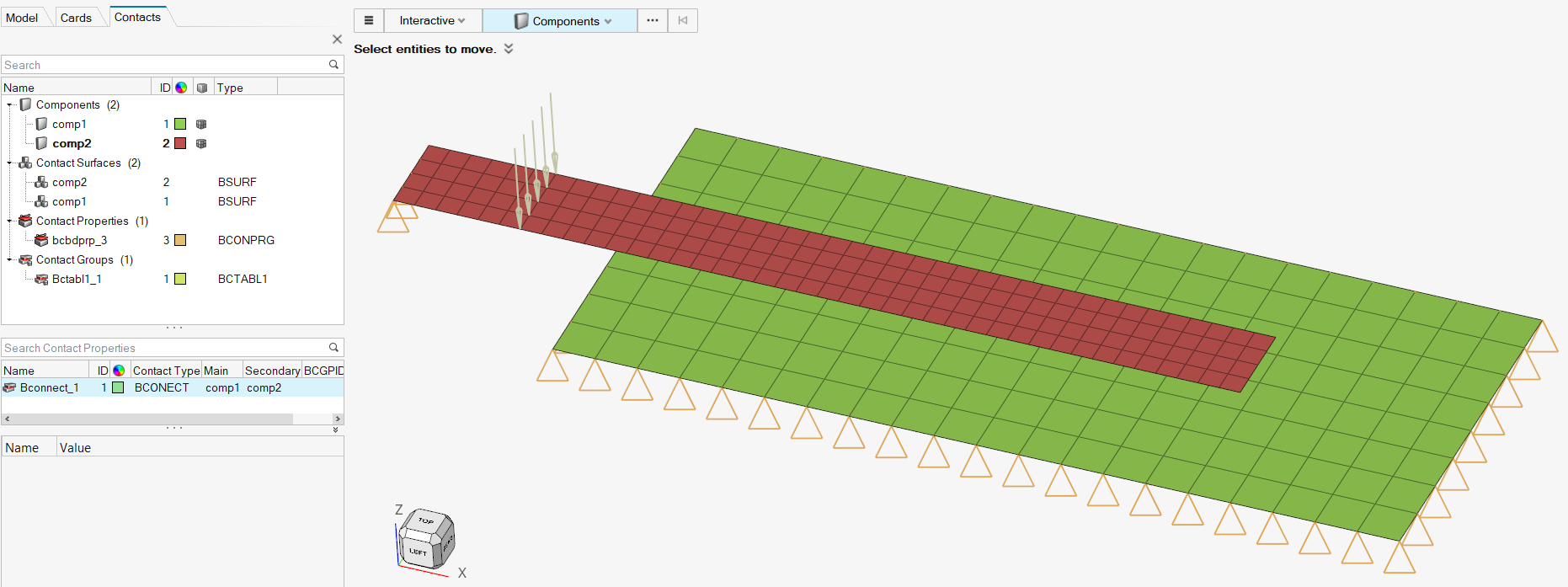

Hi guys, I am trying to set contact for linear static analysis. I am working in HyperMesh 23.1. From previous colleagues I found a model made in HyperMesh 14.0. This model is working OK after analysis start in NASTRAN.
Based on this model I tried to make the same one - imported old model to hypermesh 23 and created the same. But obviously, the contact setting has changed comparing to hypermesh 14.

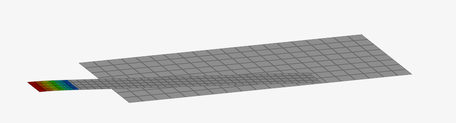

Based on some tutorials I tried to create model in Hypermesh 23.1, however, it still does not work. In the picture you can see the brief contact setting. The red comp should bend in case of contact occur. In my case, no contact occurs on green comp. and no stress.
I also attach bdf file of model created by me in HM23.
