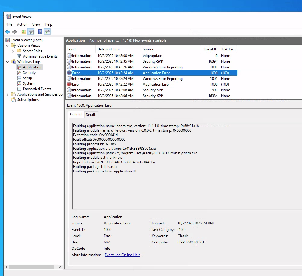

I am trying to run Altair EDEM 2025 on Azure Virtual Machines but the application crashes immediately on launch. To verify if the issue had been fixed, I also tested with EDEM 2025.1, but the result is the same.

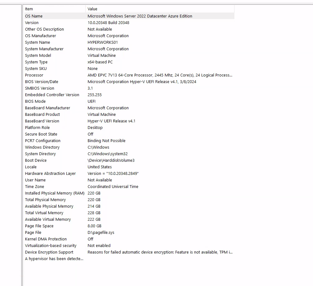

Environment tested:

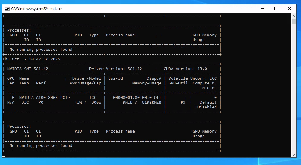

- Azure VM types with NVIDIA GPUs: T4, A10, A100
- Operating systems:
- Windows Server 2022 Azure Edition
- Windows 11 Enterprise (fresh installation performed for testing)
- License is correctly configured via Altair One
- No detailed crash report is generated, only a generic Event Log entry.
