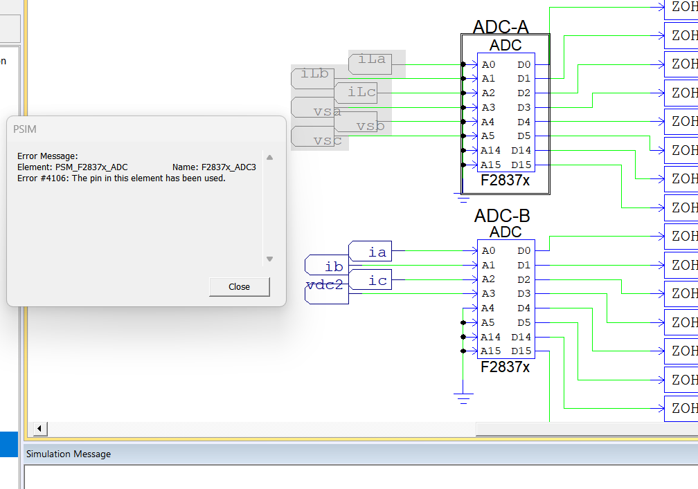

By using the code generation for the F28379d I'm getting an error that makes no sense to me. It is the first time I get one of these.
"Error #4106: The pin in this element has been used. "
Used where? By whom?
