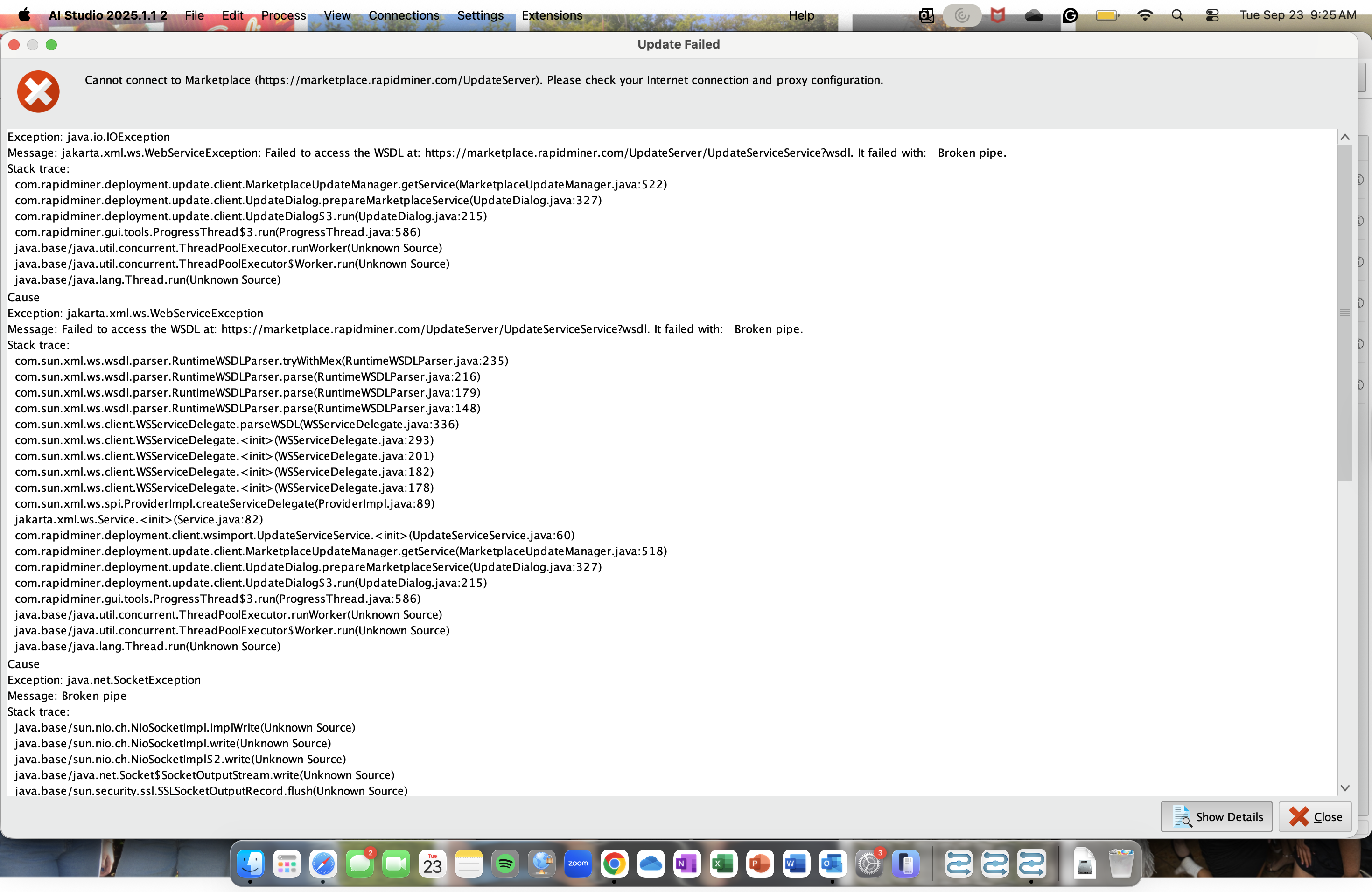

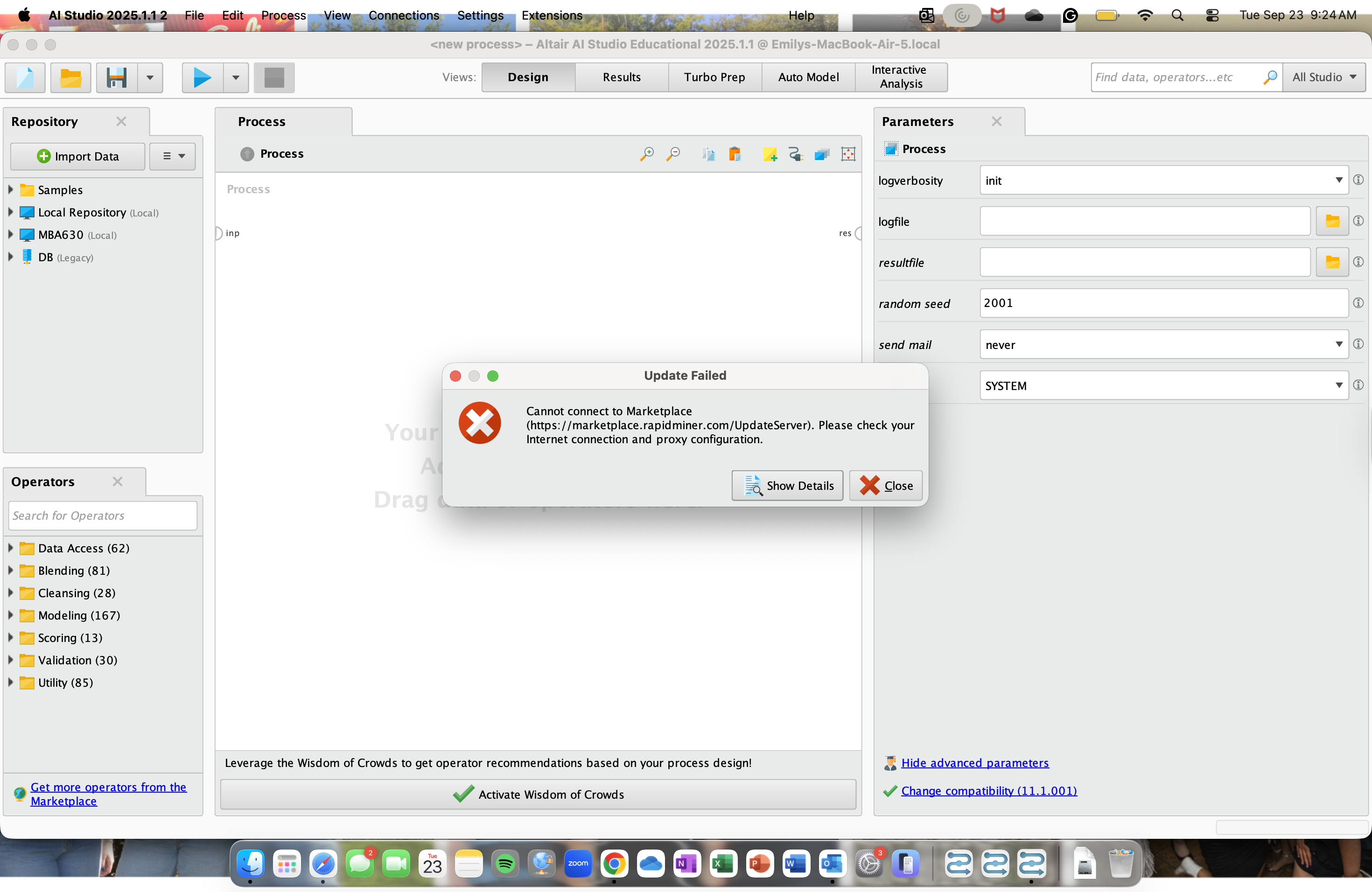

Hi! I have downloaded every single 2025 Rapid Miner AI Software and have not been able to download any extensions. I have a Mac and have a student account. It says it failed with a broken pipe in the error message. Please help!

Hi Nicholas,
I did exactly that (went into extensions tab). Once I click marketplace it sends me this. This is partially the details it gives me. I am unsure where to find the log. This error happens every time I try and go on. I just tried it again not too long ago, I would estimate around 5:30PM EST.

Sep 24, 2025 7:24:53 PM WARNING: Error checking for updates: java.io.IOException: jakarta.xml.ws.WebServiceException: Failed to access the WSDL at: https://marketplace.rapidminer.com/UpdateServer/UpdateServiceService?wsdl. It failed with: Broken pipe. Sep 24, 2025 7:34:47 PM WARNING: Could not connect to the marketplace.
