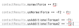

Based on my own understanding, here’s what I tried:
First, I noticed that contactResults.normalForce
applies a force to element1
and an equal but opposite force to element2
. So I assigned F2
to contactResults.normalForce
, assuming this would apply -F2
to element2
Then, since element1 should not receive F2
but only -F1
, I tried adding -F2 - F1
to contactResults.usNormalForce
. This way, I thought the effect of F2
on element1 would be canceled, leaving only -F1
For torques, I used contactResults.usAdditionalTorque1
and contactResults.usAdditionalTorque2
, as the documentation indicated that these fields allow applying asymmetric torques to each element.
