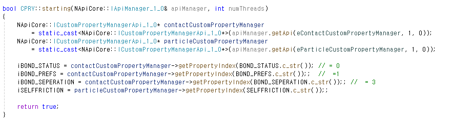

Problem
The problem I am facing is as follows:
When I run my code, the simulation stops with an error indicating that it is accessing an invalid pointer. After several tests, I discovered that this issue occurs because the pointer for the particle custom property is not created correctly. To summarize, my main problem is that I do not know how to use and assign both particle custom properties and contact custom properties simultaneously.

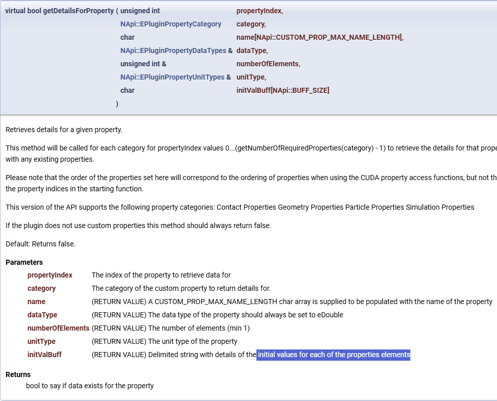

Questions
- How can I properly create both particle custom properties and contact custom properties, manage them with the API manager, and ultimately access their "value" and "delta" correctly in the
calculateForce
function? - At each time step, is the delta value of a custom property indeed initialized to 0.0, as defined in the
getDetailsForProperty
function with oss << 0.0
? - Is there a way to declare and use an array that maintains values within a single time step but resets when the time step changes? If this is possible, I would not need to use a particle custom property at all.
Thank for advance!
Here's my codes.
