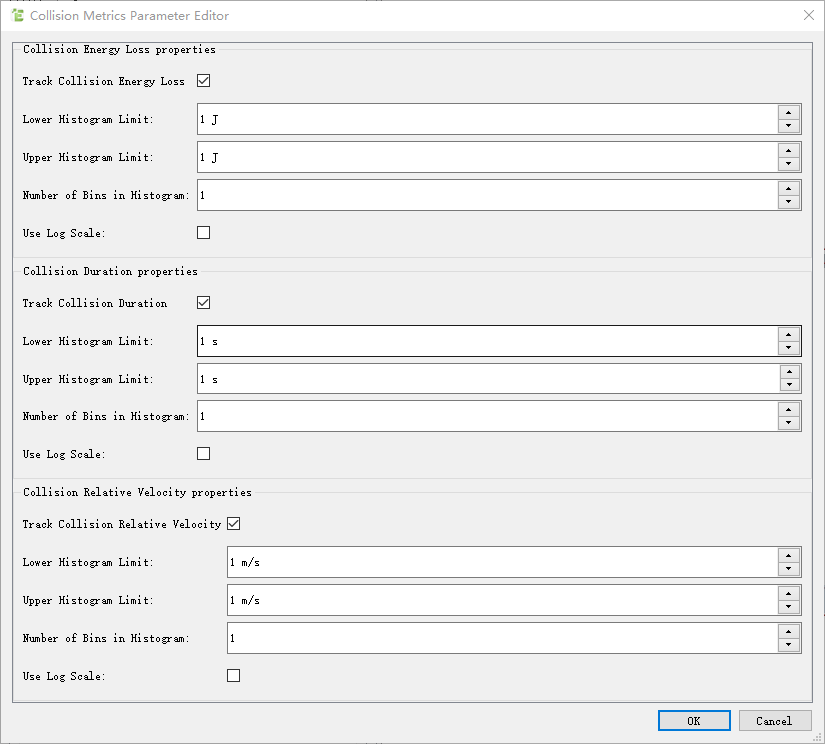

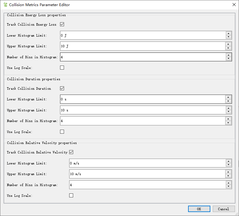

While in the Creator, go to the Physics section and add the model as a particle-particle or particle-geometry contact model. Once the model is added, click on the wheel icon and then you can choose which metrics you want to track, and you can set the parameters used to create the histograms. If the model is added as both particle-particle and particle-geometry, the parameters in both GUIs must be the same.
