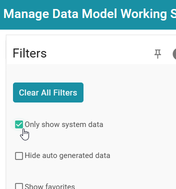

Here are the steps to explore the Ontology Structure .
- From the main menu, navigate to the Model section.
- In the Model section, click the filter icon.
- In the filter options, select the checkbox to show only system data.

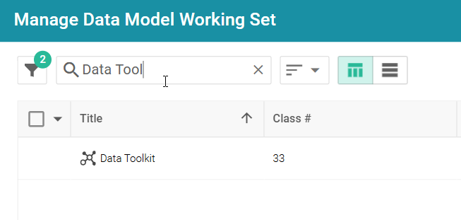

- In the filtered list of ontologies, we will see the
DataToolkit
ontology.

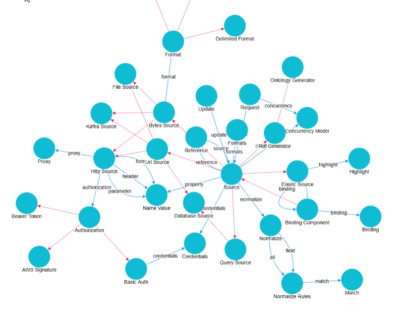

- Click on the
DataToolkit
ontology to inspect the classes, properties, and inferred relationships
- Expanding the relevant options on the left, helps us understand the structure and supported parameters in our ontology.
