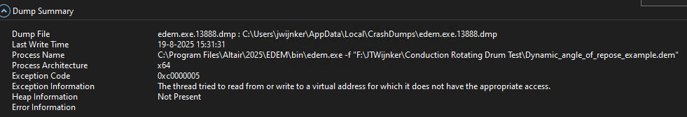

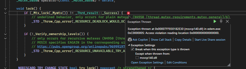

This works in single-thread mode but likely races in multi-thread mode when many particles are created/processed simultaneously and my EDEM crashes silently with the following crashdump.
I feel like the main issue is that I declare isThreadSafe but that the script is not multi-thread safe and therefore upon generation of many particles in the first time step immediately crashes.

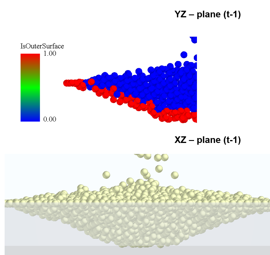

This plugin identifies surface particles of the feed pile so only those feel convection. A screenshot of how this looks is provided below. The script tags the outside particles.

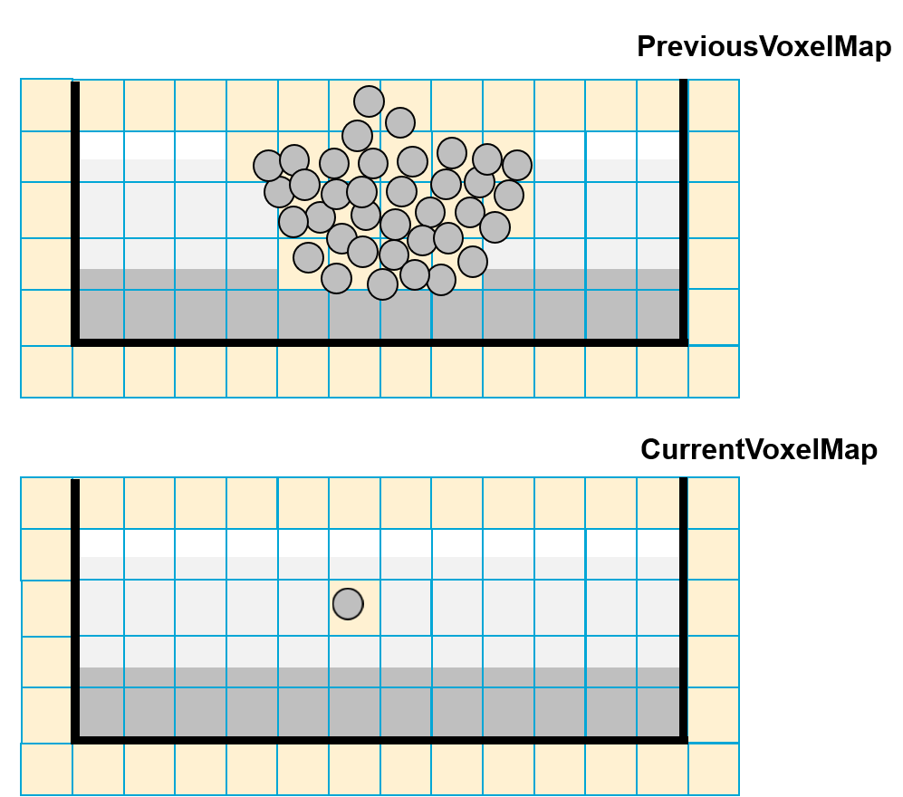

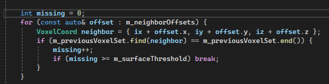

To realise this, I discretize the domain into voxels (cells). This looks as follows:

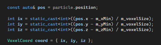

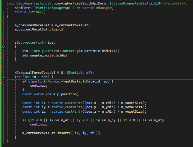

 Each timestep I:
- compute each particle’s voxel location and add it to
m_currentVoxelSet - compare

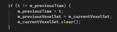

m_currentVoxelSet to m_previousVoxelSet to find surface voxels/particles. (looking at empty neighbour cells) - swap/clear the sets for the next step
The relevant code:
Because externalForce() is run in parallel, the shared m_currentVoxelSet is written concurrently. That likely explains the crash when many particles are inserted/processed at the same time

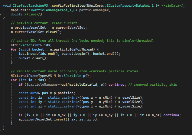

Please show the small code change I should make. - CSurfaceTrackingV2:
I currently insert voxels into one shared set inside externalForce(int threadID, …) and swap/clear sets when time changes inside externalForce.What is the EDEM-2025 best way to do this MT-safe
Is the correct pattern:
1. in starting(..., numThreads): allocate per-thread voxel sets,
2. in externalForce(threadID, …): write only to threadID’s set,
3. in the single-threaded end-of-step callback (please confirm the exact name in EDEM 2025): merge per-thread sets, then swap/clear?
A 10–20 line sketch showing allocate → collect → merge/swap would be perfect.
