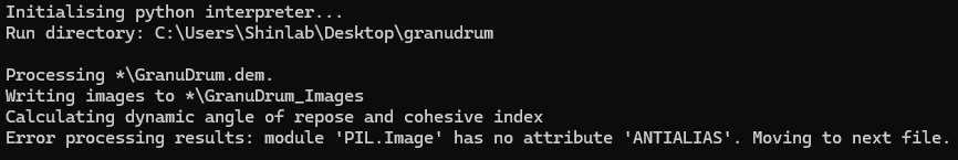

EDEM calibration kit 중 granudrum 시뮬레이션을 진행하고 EDEMpy script를 실행 하는 중 그림의 오류가 발생하는데 어떻게 해결해야 할까요?
Can you try this version. It looks like there was a change in PIL version. Changed line 695 to Image.LANCZOS instead of ANTIALIAS and it works.

Thank you for your response. I am currently using Python version 3.8.10 and EDEM version 2025.1.
However, when I run the script from the EDEM Analyst, I encounter an error (see screenshot below). Do you know how I can resolve this issue?
Hi, I don't see the error from the Analyst? Could you add this.
Thanks, Stephen
This error occurred when I ran the script through Run EDEMpy Script in EDEM Analyst.
