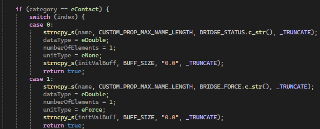

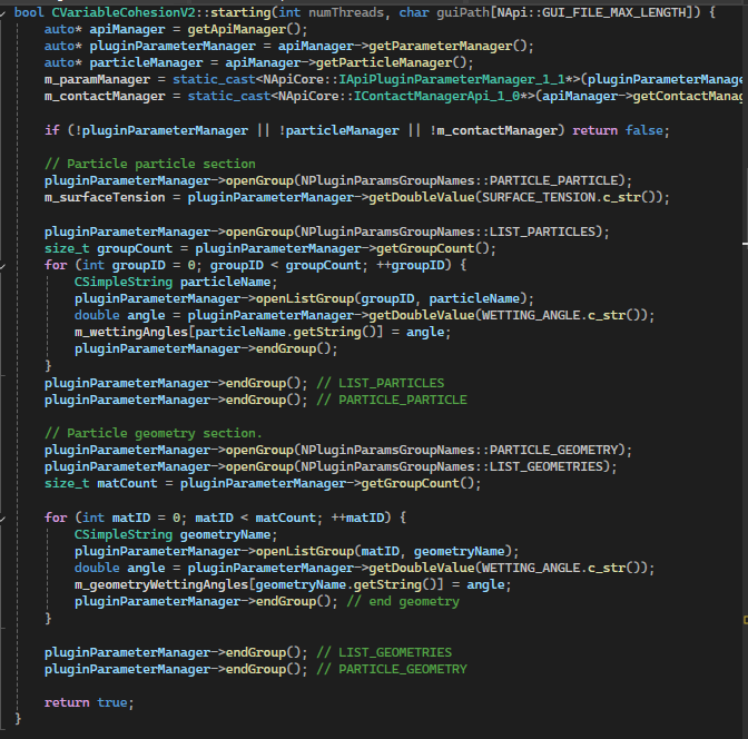

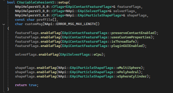

I am currently working on my own liquid bridge model. Now, as inspiration I am using the CLiquidBridgeModel.cpp that was provided here in the discussions as API Example.

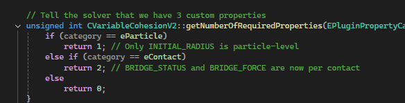

This CLiquidBridgeModel uses custom properties m_BridgeStatus, m_BridgestatusDelta as well as m_BridgeForceDelta and m_BridgeForce.

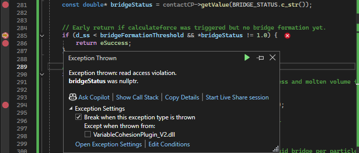

I have tried implementing this as well but my plugin results in EDEM silently crashing immediately after start of the simulation (first loop). Whenever I try to debug in MSVS I can see where it goes wrong. I have added a safeguard to make sure that the code exits calculateforce() early if there is no liquid bridge yet present and if we are not within the distance that a bridge should form (to safe computational load due to larger contact radius). When this if statement is excecuted it tries to use the BridgeStatus which is a nullptr. This results in the following error:
I don't understand what I am doing wrong in my script and why it is different from what is done in CLiquidBridgeModel.cpp. Why does the bridgeStatus getvalue not work correctly?
