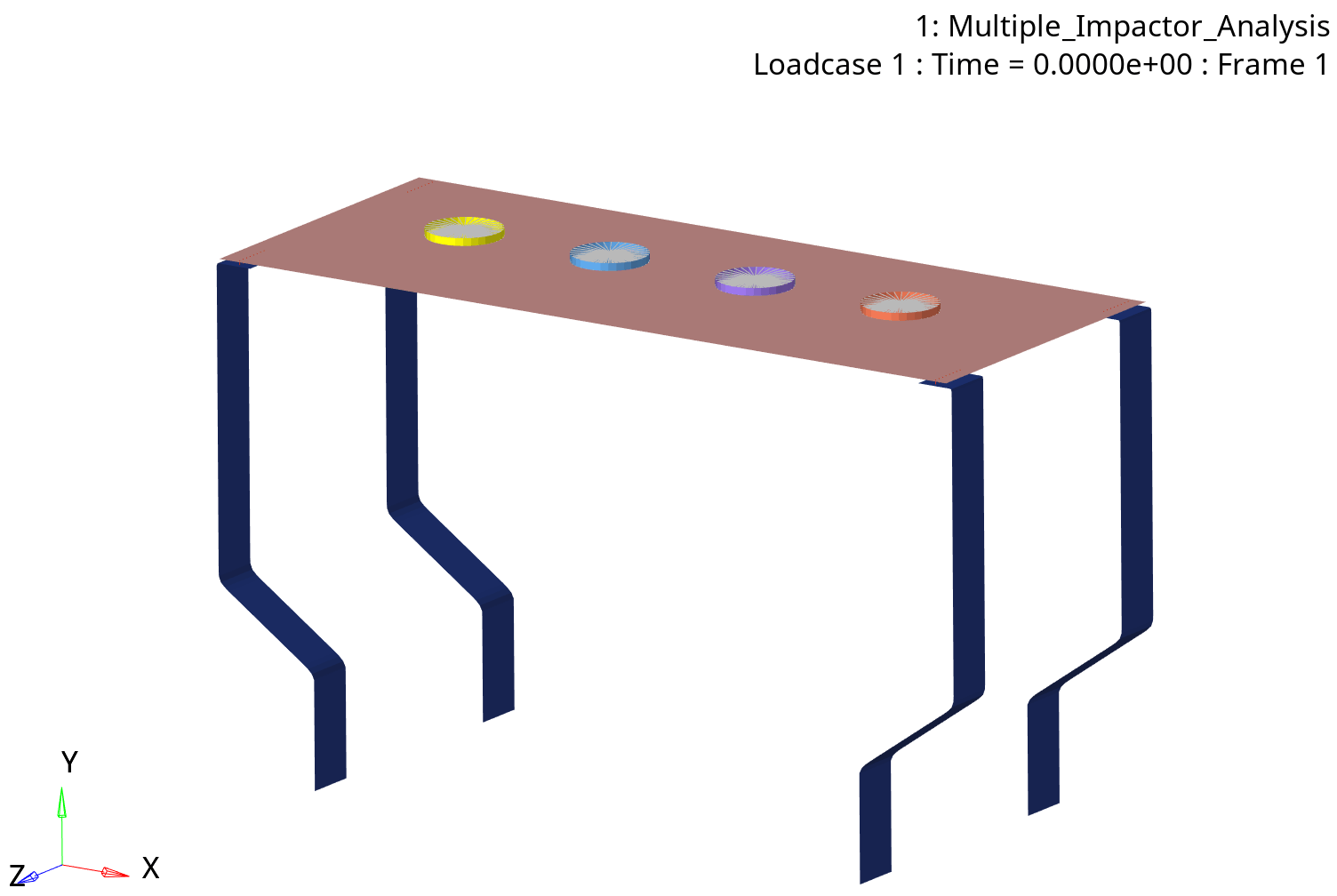

Type 01 - Object/Assembly is fixed, and multiple impactors will be made to impact. The positions of these impactors are known prior to the impacts

Type 01 – Multiple Impactors Drop

- Multiple drops of impactors can be simulated using multiple engine files.
