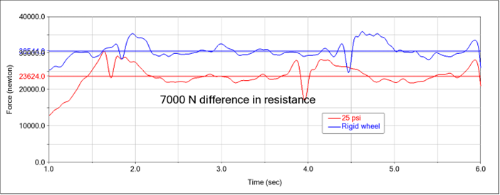

In the example shown below, rolling resistance is compared between a rigid tire and the flexible PM FlexTire™ under identical conditions. The results show that rolling resistance is significantly lower when using the flexible tire, which is attributed to reduced soil displacement compared to the rigid tire.
