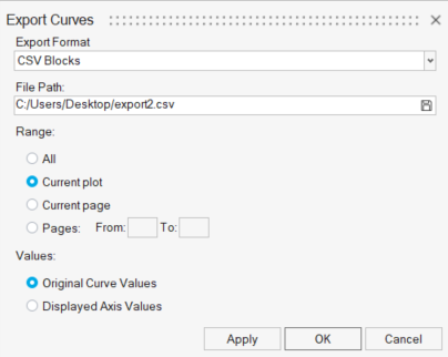

Is there a way you can extract element (306 elements) forces for 600 Load cases in one go? Some like PATRAN, which is called REPORT, and it is very easy to use.
I need this data for postprocessing in excel sheet.

You can export plots on different format types, including csv blocks or excel, using HyperGraph on File > Export > Curves.

Thank you very much for your reply. I will give it a go and let you know. I just don't get how I can export the results for all the LCs in one go. It seems like I have to lot every single LC (and they are too many, 600 in my case) and then export the results for each one at a time. That means I have to repeat the process 600 times!!!
