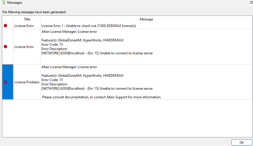

I installed altair edem 2025 on one of the new computer at the university and i keep getting this error when ever i try to access edem
please tell me how to fix this

I am not using a student license. i am using the license server of the university.
Just to note you can start EDEM with:
edem —server "servername" to select a specific server. For 'servername' you can put the IP or name of the server. For the 'edem' command you will likely want to specify the full path to the 2025 install EDEM/bin/edem folder.
