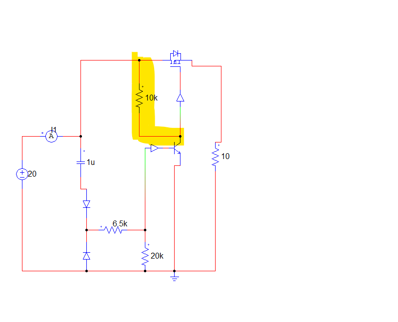

PSIM2022版本中,如何实现:通过NPN的导通控制p-mosfet的栅极为低电平,进而实现p-mosfet的导通。我遇到的问题是:将NPN三极管的集电极通过开关控制器连接在p-mosfet的栅极上进行仿真时,会报错,报错信息见图一,仿真电路见图2.期望得到回复,感谢。

Hi,
I have verified the simulation and no Vcc at collector terminal. Can you please check the circuit once?
For your reference I attached the image, in which I connected Vcc and circuit runs without error (Please see attached pic).
Thank you,
Vishwanatha Siddhartha
