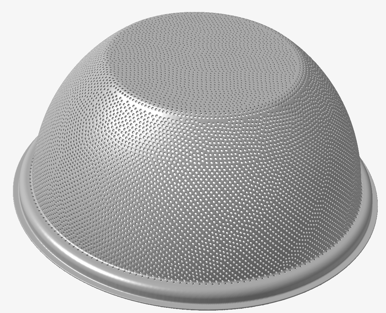

Overview:
Are you looking for a way to quickly create thousands, or even millions of circular holes on your part? Inspire unlocks this capability through implicit geometry. (Checkout Inspire Docs on Implicit Geometry to learn more) This extension will enable you to quickly add thousands of evenly spaced holes on any surfaces of your part, which can be especially helpful in additive manufacturing. It is as simple as selecting your surfaces and choosing hole size and distance away. Thank you for using the Perforate Tool!
Prerequisite: Inspire v2023 or newer

  9. All selected surfaces should appear in red. After you have input all your correct values, you can click the green checkmark button to run the tool. Progress % will appear on the far right of the guidebar. image.png image.png
  10. A new "Implicit Part" will have been created. This is the new part with the perforations. image.png
